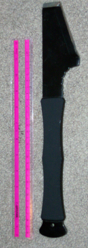

About eighteen months ago (if not more) one of my best friends began asking me for a small cutting / pry tool that he could mount in the middle of his response vest. Although this man DOES do "tactical" work, by and large he's an administrator. There was no rush and I was trying to find just the right tool. I found many, but not one that I was satisfied in recommending to him unconditionally. Just this past week though, while attending a writer's seminar, I was introduced to a new tool that will be on the market soon: The Small Pry from Dynamic Entry.
The Small Pry is made from D2 tool steel and measures just about 14.5" long. Because it is specifically designed as a pry bar, the strength has to be good while the durability and corrosion resistance have to be pumped up as much as possible. To accomplish this Dynamic Entry hardened the steel of the Small Pry to an RC-55-57 level. To help prevent corrosion the steel is finished with a black epoxy powder-coat layer that will provide a clean non-reflective matte black look. The handle is thermoplastic rubber over-molded onto the handle and contoured to increase friction in the hand (a better grip).
Set at an angle the edge is just under 4.5" long and will be available in plain only (no serrated option). The front tip is not sharpened and is meant to only be used for prying. So, why a combination pry tool / cutting / chopping tool? You never really know exactly what you're going to need when you go on an entry, so you try to carry what you think you'll need. If you can carry one tool that increases your versatility of operations, that's a good thing, right? The Small Pry is designed to be used for specialized entry functions like prying interior doors and drawers, window "break-and-rake" operations (that's why there's that curve that juts the bottom edge away from the handle), and tactical cutting chores like removing screens or chopping through drywall.
