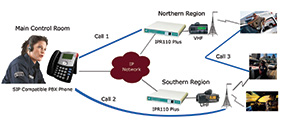

     What does this mean? In a county police department SIP-based interoperability solutions enable the sheriff to pick up a PBX phone in the office or at home and speak with remote radio users. Providing an efficient use of the network, these users could be at several locations throughout the county on different repeater sites, and each call can be made to a specific repeater site. Calls can be set up to talk to several sites, allowing greater connectivity over a wide area. After the conversation has finished, the call can be broken down, leaving the network free for other users. This means there is no need for a centralized operator to monitor and control all calls, as demonstrated in Diagram 1 on Page 72.

     Users have traditionally required different interfaces depending on their duties, i.e. dispatcher, maintenance technician or manager. IP-based solutions offer many interface options including IP dispatch software, dedicated consoles or SIP compatible PBX phones. Wherever the Internet can be accessed, a technician can monitor and talk over the radio network. Users select the operator interface device best suited to their needs as outlined in Diagram 2 below.

     Translator functions built into VoIP/SIP gateways convert SIP point-to-point connectivity to point-to-multi-point connectivity. A phone user can now access multiple repeater sites. This radical development further expands the communication reach for wide area networks and adds a new level of interoperability. Diagram 3 (on Page 73) demonstrates the power SIP protocol can bring to interoperability.
