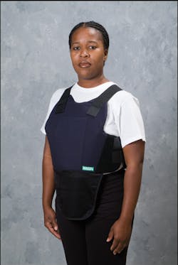

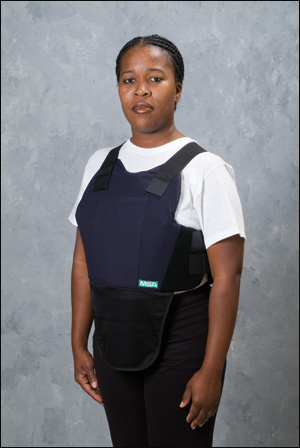

   Campbell says today's armor has come a long way since those he wore as a military policeman and later as an Oakland (Calif.) patrol supervisor and SWAT team leader.
   "My first vest was 100-percent Kevlar. It was square, maybe 13 inches by 13 inches on my chest and my back. It was very thick," says Campbell, now a director of ballistic protection sales with MSA. "It was like wearing a postage stamp." Since then, Campbell has worn a variety of different armor, including a Zylon-containing vest for nearly four years (before the aging and degradation problems with Zylon were recognized). He says over the 18 years he wore ballistic protective vests, he found that hybrid vests, such as MSA's KNX Ballistic Packages in Level II and IIIA, are his favorite. The newly certified vests use woven aramid as well as unidirectional aramid fibers, which makes them a hybrid.
