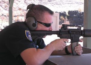

We put the TR-15 through its paces on a more than 100-degree day in Oakdale, Calif. I expected that by the time we ran through a couple magazines, the heat signature would distort the sighting plane. It didn't, but it also didn't take long to make it too hot to touch. We were shooting within carbine ranges and printing better than expected results with the supplied iron sights.
Probably one of the most overlooked advantages of the AR-15 in law enforcement is the entirely inline system, where axis of the bolt carrier, buffer and recoil system goes directly to the area where the carbine mounts on the shoulder. When a shooter puts the hearing protection on and fires a few rounds downrange with a carbine, there is a distinctive captured spring sound as the buffer is forced down the stock tube. I can only describe firing the TR-15 in an intangible way: It seemed to cycle smoother than its mass-produced counterpart.
