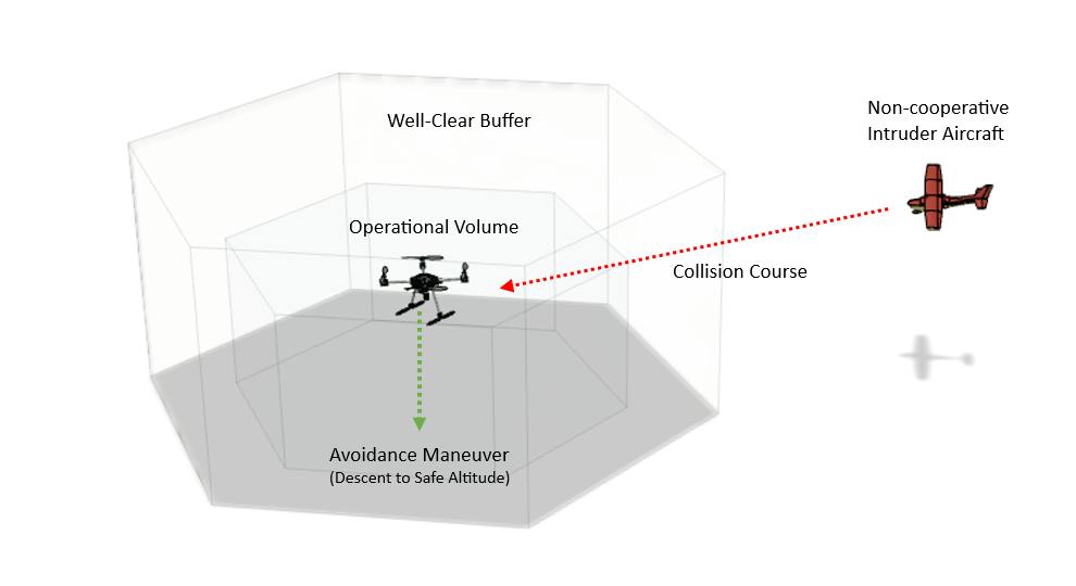

To strike a balance between allowing RPICs sufficient reaction time for avoidance maneuvers and maintaining a safe distance from non-cooperative crewed aircraft, Appendix A of the RTCA DO-381 [1] standard has been used for the worst-case scenario calculations. It grants RPICs adequate reaction time to execute avoidance maneuvers while ensuring a well-clear distance from non-cooperative crewed aircraft. By adhering to the Appendix A calculations, DFRs can assess the real-time operating airspace for each UAS flight, considering factors such as the UAS's speed, descent rate, the speed of non-cooperative aircraft, and reaction times of the RPIC. Through this standardized approach, DFRs can ascertain a safe detection volume for the radar-based GBSS, allowing it to scan and detect non-cooperative aircraft effectively.

Optimizing DFR Operational Volume
The main concern of DFR customers and integrators is: “What is the radius/area of my DFR Operational Volume?” How large is my Operational Volume? How much time does the UAS have to get to a safe altitude after an intruder aircraft has been detected (the radar started tracking).
Optimizing the Operational Volume (OV) for DFR operations is essential for successful adoption and deployment.
To estimate that time (which translates into distances), we can use the following example:
What distance has the intruder aircraft traveled by the time the UAS has descended to a safe altitude?
Add to that distance the airspace safety clearance requirement of 2000ft/610m.
Now add #1 and #2 and subtract from the distance the intruder aircraft was when the radar started a track.
Consider the worst-case scenario at which the intruder aircraft is the shortest time/distance from a collision with a UAS at the outer edge of the operating volume. The operating radius is calculated as follows.
  • Decision & Descent Distance traveled.
  • Intruder distance traveled before decision.
  • Intruder velocity [m/s] * time [s] to initiate the avoidance maneuver.
  • Intruder distance traveled while executing the avoidance maneuver.
  • UAS descent rate[m/s] * descent distance [m] to safe altitude
As an example:
The intruder aircraft travels at 56m/s
The RPIC takes 5s to initiate the avoidance maneuver (Directive Descent – see above)
The system takes 0.1s to react to the RPIC input.
The UAS descends by 15m at a rate of 4m/s à 3.8s
That’s 8.9s in which the intruder aircraft has traveled 498m.
Add the Well-Clear Buffer
Now we add the regulatory Well-Clear Buffer of 610m which results in a 1108m separation needed between the point the intruder was first tracked and the outer boundary of the operating volume range.
The MatrixSpace Radar Tracking Distance is the main determining factor in driving the operating volume range.
Let’s assume a Radar Tracking Distance of 2000m, which in turn would result in an operating volume range of:
Below is an illustration of this scenario in a real-life situation with a single 360 Degree MatrixSpace Radar Node over San Jose (SJC) airport:
The blue area is the Operational Volume, the yellow area the Well-Clear Distance, plus the time traveled by the intruder from RPIC alert until the UAS has reached a safe altitude.
At a tracking range of 2000m the actual DFR Operational Area radius is 892m, resulting in an Operational Volume of 0.3 km^3 (@400ft/122m ceiling).
