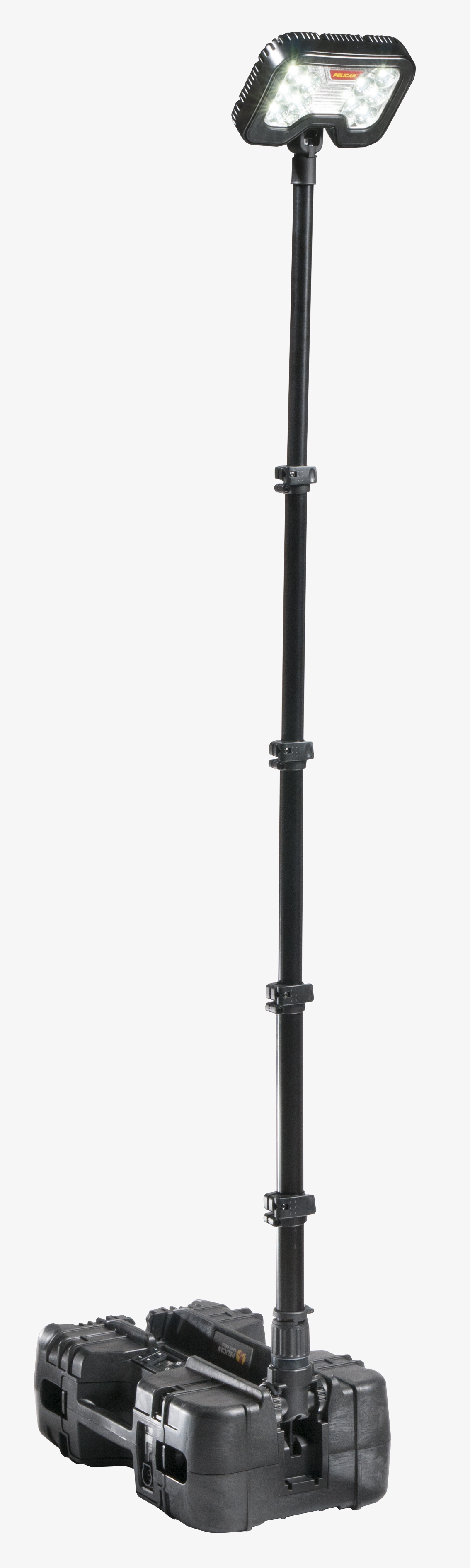

Pelican 9490 Remote Area Lighting System
The Pelican™ 9490 Remote Area Lighting System features the ability to be used while charging. When the charger is connected to AC power and the product is switched on, the 9490 will automatically select a light level to allow continuous operation - automatic mode. (In this mode, the battery level will remain constant. The light will be at a 50% level.  In AC mode the display will show the battery level and power level but the time display will be replaced by --:-- and the hourglass icon will be extinguished.
Manual adjustment of the brightness will still be possible. If the brightness is increased, then automatic mode will be exited, a new runtime will be computed based upon the new operating conditions. The battery level and the display will revert to the normal IC mode, (or preset mode if the bottom left button has been used).
If the brightness is decreased, the unit will remain in continuous mode (and the battery will charge up slowly).  If the charger is removed, the unit will return to normal operation and the run-time display will show the remaining time for the selected setting.
