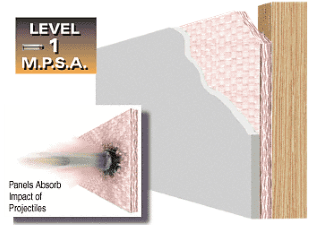

CR Laurence Bullet Resistant Fiberglass Panels are flat sheets of a polyester laminate reinforced with a fiberglass scrim to create a material with superior durability. The densely packed structure of the panel exhibits an excellent capability to absorb multiple impacts from high velocity projectiles, limiting ricochet or shattering. They meet the standards of U.L. 752 Ballistic Performance Requirements Test, as well as all bullet resistant test requirements set forth by the National Institute of Justice.
Typical applications include the lining of bank teller counters, ticket booths, judge's benches, doors and walls of secure enclosures, and other structures where concealed panels will add to the safety of service personnel. Panels are high pressure molded into standard 96" x 48" (2.44 x 1.22 m) size sheets. Cutting and drilling can be done using commonly available tools.
