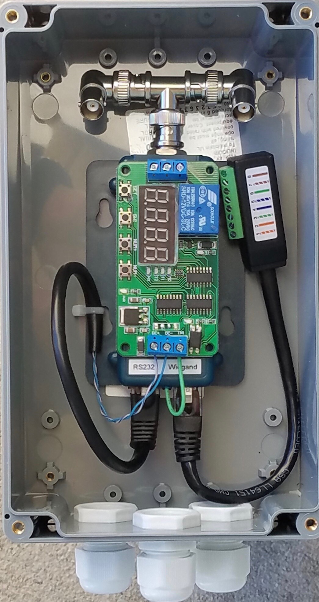

  • Compatible with all Handicap Automatic Door Operators
  • Provides 26-Bit Wiegand protocols and Timer Relay
  • Small, lightweight, with low 12VDC power draw
  • Adjustable Tag read range (10’-50’+) with standard Omni-Directional Antennas
  • Encrypted Transmission between Tags and Readers
  • For Disabled and Blind Students / Faculty
  • Additional Long Range “Plug and Play” Directional Antennas available on request
  • Readers communicate with any Wiegand based Access Control Panel
