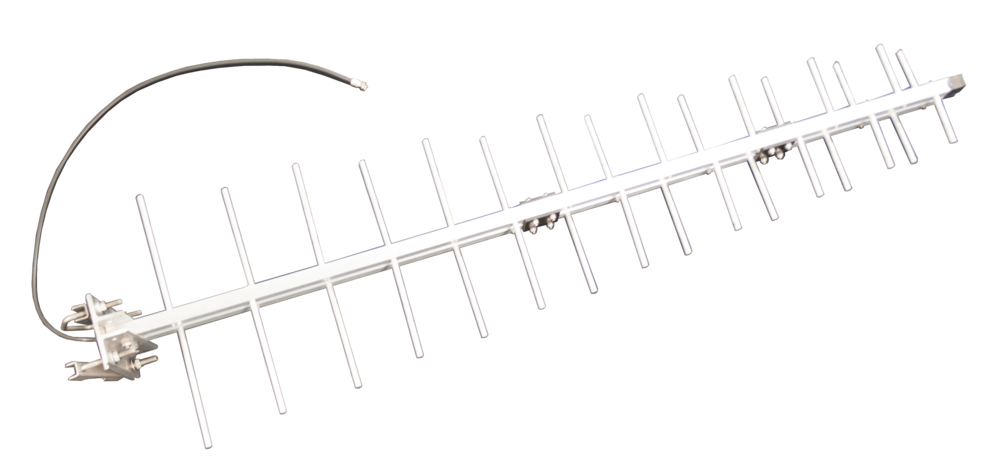

High-Gain Yagi Directional UHF Antenna for RuralConnect CPE
  • Active Elements: 32
  • Element Diameter: 5/16-inch Beamwidth, 16• +/- 1dB
  • Gain: 12-14 dBi
  • Maximum Height: 14 inches
  • Maximum Width: 5 inches
  • Maximum Length: 51 inches
  • Polarization: Vertical or horizontal
  • Shipping Weight: 7 pounds
  • Carton Dimensions: 15 inches by 15 inches by 22 inches, 2 per carton
  • Connector: "F" type female
  • Output Impedance: 75 ohm or 50 ohm
  • Cable: 2-foot RG6 pigtail included
  • Wind Operational: 100 mph
  • Wind Survivable: 120 mph
This log periodic directional antenna features narrow beamwidth for reduced co-channel and multi-path interference, as well as optimized high gain performance on longer paths. This antenna is rugged enough for mountaintops with up to 1inch of ice build-up.
