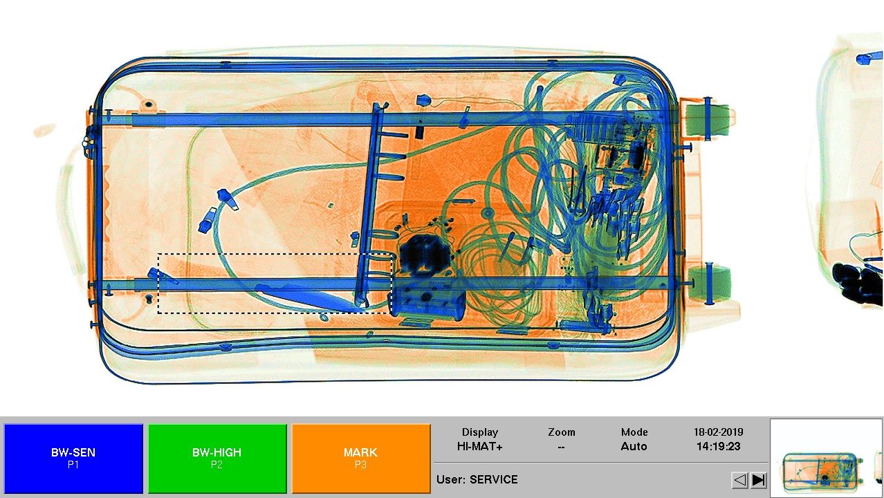

Offering automatic detection of handguns (pistols, revolvers), gun parts, flick and fixed-blade knives (min. length ~6cm), the weapons module was developed for use in a range of applications such as aviation passenger checkpoints, critical infrastructure protection, prisons and customs. It is available for the HI-SCAN 6040aTiX and HI-SCAN 6040-2is scanners. A weapons algorithm for the HI-SCAN 6040 CTiX has also been developed and is now ready for customers to trial.
The weapons kit is offered as an option on new systems or as an upgrade. Potential threats are framed and shown on the main system screen in tandem with the images from the explosives detection scan. The supplementary function does not affect any regulatory certifications or approvals.
