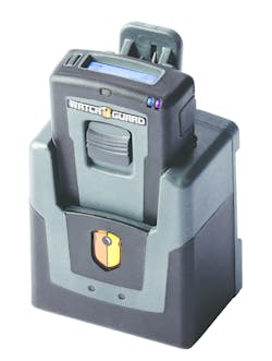

  • Number of Audio Sources Supported 3 (2 wireless, 1 wired standard)
  • Audio Compression MPEG multi channel
