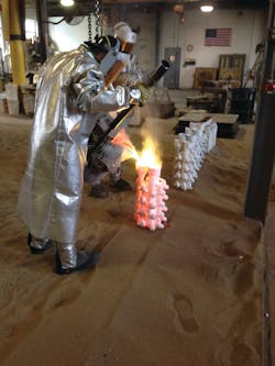

They formulated a custom mixture of over four alloys for the Claw’s head. It takes their foundry three weeks to pour to be ready for assembly.

They formulated a custom mixture of over four alloys for the Claw's head. It takes their foundry three weeks to send it to JTC for assembly. There the handle undergoes a sprial-grind and an epoxy resin is set into the threads -- this epoxy takes 24 hours to set. Clearly JTC has no intent in rushing the production process.
