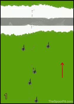

Diagram 1
(Note: the diagram intervals between team members, spacing and size of the operational area are not to scale.) The red arrow indicates the direction the track line is taking them. The team's two flankers (LF and RF) out to the sides of the Y formation as they should be, tracker (T) on the track line and controller (C) back from the tracker, with a rear security tracker (RST) at the rear, alternately glassing ahead with a weapon optic or binoculars and then checking security to the rear of the team.
