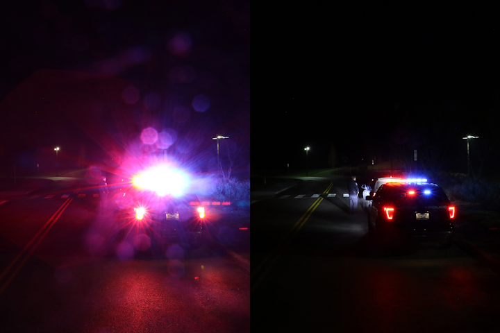

These before and after photos show a conventional flash rate on the left and a situational based flash rate on the right.

It is 2010 and Massachusetts State Police is noticing that the incidences of rear-end collisions to stationary police vehicles are on the rise — after just purchasing the next round of high intensity LED lightbars. During a two-month span in the summer of 2010, there were ten cruisers hit while parked on the interstate with flashing lights active. One incident on June 18 took the life of 52-year-old Sgt. Douglas Weddleton, a father of four. In each of the instances, the motorists that hit the cruisers were impaired. Administrators from MSP reached out to engineers from Whelen Engineering, Co. for guidance. They knew they had enough bright flashing lights. The question was, were they using them right? Together the teams from both entities embarked on a nine-month study. They looked at flash rates and flash intensities and compared those from a variety of colors and how they might be perceived by a passing motorist. They looked at other lighting studies that talked about a “moth to a flame” effect, where some (particularly impaired) motorists would tend to focus on and then drive directly towards bright, dazzling light. Testing was conducted at their closed vehicle course during daylight hours, dusk and even late night, low-light conditions. Travel speeds were obtained to re-create the most accurate scenarios. They even included unbiased civilians as part of the evaluations.
At the conclusion of the study, it became clear to all involved that the warning light flashes and brightness that are appropriate while responding to an emergency call during the day are not appropriate while parked on the side of the interstate at night, and vice versa. Using the high intensity bright, dazzling warning lights while calling for the right of way during daylight may very well capture the attention of others and make for a safer response. These warning signals must be incredibly intense in order to compete with the sun. Take the sun away and using that same signal while stopped at night appeared to be causing two major safety problems.
Not only does it cause people to subconsciously stare at them, resulting in the previously mentioned “moth to a flame” effect, but it temporarily distracts approaching motorists who now may not be able to see the trooper or other first responders standing in the roadway.

Using simple if/then programming logic, the warning system control unit now knows that if the vehicle is in drive, and the warning lights are active, then it should display a rapid, alternating, high intensity dazzle as a message of urgency. If the vehicle is placed in park, with the warning lights active, under nighttime or low levels of ambient light, it will automatically adjust the flash rate down to a slow, fully synchronized, in/out flash at a much lower intensity and may include a mix of low power steady burning light.
